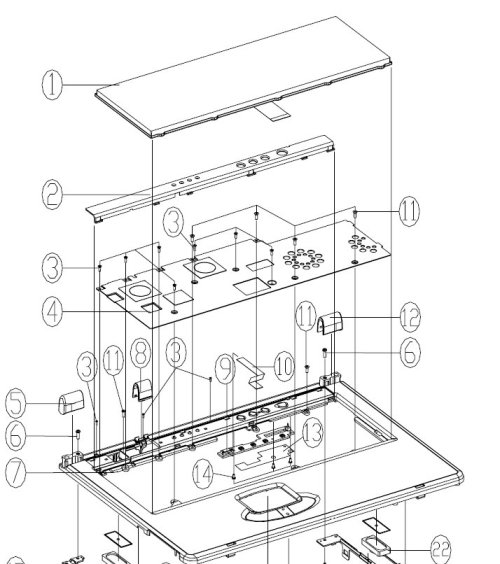

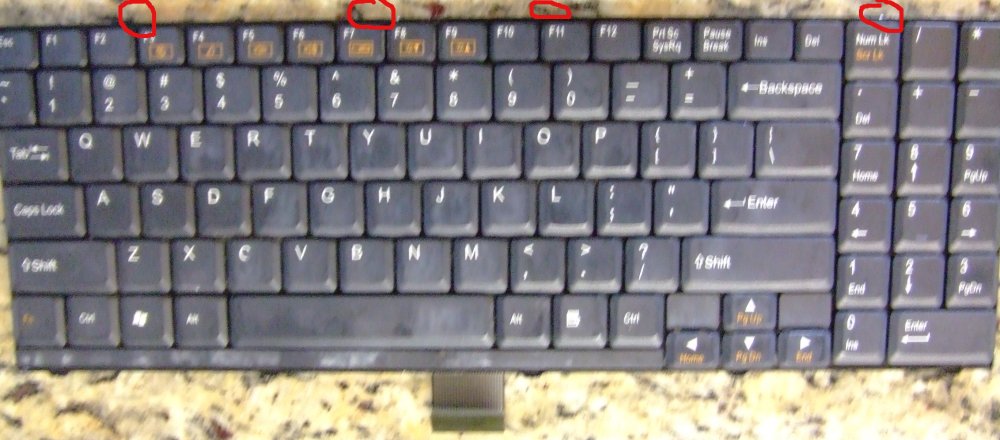

Remove the keyboard from the computer.
This unit easily unclips (no screws). The clips are located along the top edge of the keyboard and can be depressed with a small blade screwdriver to release. (See areas encircled in red).
